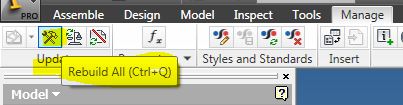

Have you tried doing a complete rebuild to see if that will spark the change?
