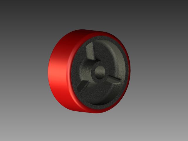

I decided to model an industrial iron caster wheel with polyurethane tread, and all went well. Tonight I added three ribs to one side of the caster wheel, which looks great, but I would rather not repeat the process on the other side becaise of all the fillets and such which would have to be repeated.
Is it possible to split the wheel down the middle and then mirror the side with the ribs? I saw that I can split the model with a plane, but I can't figure out how to remove the geometry on the left side of the plane.
Thanks for any help. I'm sure my design intent was not what it should be before starting, but I'm new at this and am discovering as I go along.
Inventor 2013
Rendering is below. The other side is without the ribs.
Thanks!

I should ask, for the sake of understanding what is possible or not, can an existing model be sliced in half, with one half being discarded and the other half mirrored?
Steam
Using Inventor Pro 2015

You are mirroring "Features" that created the body, about a Work Plane and not a cut body. This may work for some models but don't hold your breath for all models.

start a sketch on the surface, draw a bounding box to enclose all that you want removed/cut and use the Extrude command, with the cut option.
Worked perfectly. Thanks. I knew there had to be a simple, elegant way.

... I can't find the elusive "slice" command even though I'm certain it's right there in front of my face!
In Inventor it is called Split.
Can also be done with Sculpt
or Extrude cut.

Ditto blair's and JD's comments regarding basic modeling technique (since I learned from them on this forum, I guess that's a given!).  Assuming that your part is centered on the YZ plane, use the Split tool with the Trim Solid option selected and the YZ plane as the split tool (see Split Tool - Trim Solid.png below).  Then use the Mirror tool with the Mirror Solid option selected and use the YZ plane as the mirror plane (see Mirror Solid.png below).  I think this is what you were asking in your original post.

Thanks Sam. That's exactly what I was looking for, the "Split" function, and I knew it was right under my nose. It amazes me how the human brain can prevent the perception of something that is right in front of our eyes.
I took a look at your images and I appreciate your efforts to clarify. I tried it and of course it worked perfectly.
