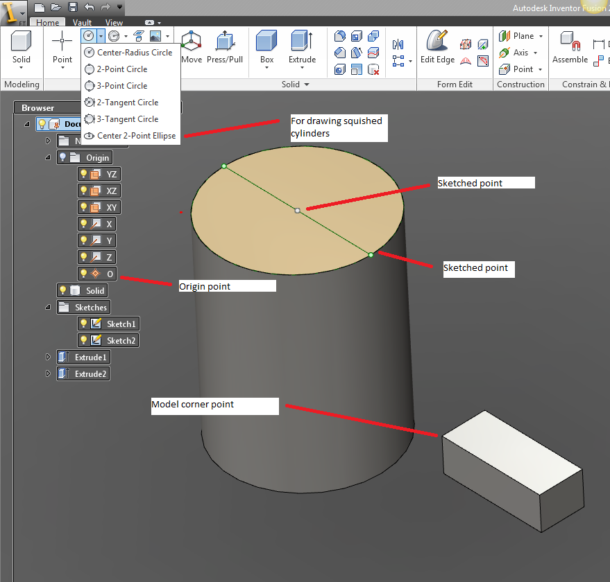

  • The sketch command "Center 2-Point Ellipse" can help you draw squished cylinders.
  • Points for scaling can be selected from a number of places: sketched points, the ends of model edges, or from origin.
Thanks!

Thank you very much for your reply, Phil! I appreciate you taking the time to help out a newbie very much.
I was able to draw a cylinder with the Ellipse tool and scale it uniformly after it was extruded from the origin point.
