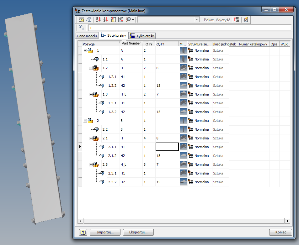

This code will not work. It will count only the assemblies in the first level. And its ok to have custom property (QTY for the moment). I'm not useing Vault so I dont have to check out all files. My rule is launched in the top assembly, searching in every related file the QTY, writing down in customQTY (I will need it in other rules), searching for the drawing and then inserting QTY in the title block. But how to count the assemblies that are used in a few subassemblies?
Let say that I have assembly with two conveyors, A & B. In the main assembly I have 2xA+1xB.
How to count how many H.iam do I need? Each of conveyors contains hangers H.iam (A has 2 hangers but its 2 times in the main assembly so its 2x2 and B has 4 hangers so 4x1) H(QTY)=2x2+4x1=8 H_L.iam is very similar to H.aim, contains the same parts but it's mirrored part do it is welded in a different way. Also has a different QTY because B.iam has 3x H_L.iam. On the end H_L(QTY)=7.
Of course this is an example, in real life this gets more complicated.
I hope you understand my poor language and my big problem. And the screenshot in Polish.

first in the stucture settings I can choose "separator" in your code its comma in my stanrardt it is dot. But the code will fail if someone will choose <none>.
Second thing is more complicated: the code is multipling all levels wchich is good but sometimes I have two machines with the same basic part and the code is writing down only the QTY of last machine.
Please look at the attachment and see if you have the same result (H(QTY)=4 and it should be 8). The tests are run in INV 2013 SP2, WIN7 64bit.
Once again thanks for the efford. I did not know how to get in the BOM structure, I made some tests with exported BOM in excel file, it was mess.

in reply to: eljoseppo
The original code, I was getting 8 for H. I wonder if it's the language is the issue. BTW, I am using Inventor 2014 SP1. But I did notice an index issue and corrected it below. I also changed the separator that my code is using from a comma to a colon. This separator is not the same as the "separator" for the BOM. It should be unrelated. What I am doing is reading each line in the structured BOM and if it's a subassembly then get the name and qty and put it into an array. I am appending the name with a colon and the qty (ex. A.iam:1, B.iam:2, etc). As I am going through each subassembly, I am comparing it to the array that i am building. I ran the following code ont the assembly you gave me and it seems to be working on my end. Try this and let me know how it works.
