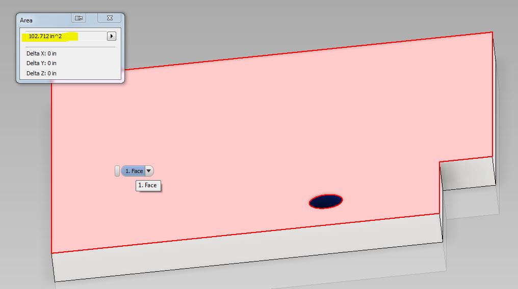

Hi
i need to be able to get the surface area of a part. i can get it using the measure tool and selecting the 'Measure Area' command but can i get the value i need via code only?
i actually need to iterate all faces on a part to find the largest one.
Does anyboby have any ideas or can help?

Something like so (VB.NET). Covers parts with multiple solid bodies.
Dim doc As PartDocument = Nothing
Dim bodies As SurfaceBodies = Nothing
Dim faces As Faces = Nothing
Dim maxArea AsDouble = 0.0
Dim faceArea AsDouble = 0.0
Dim bigFace As Face = Nothing
doc = <get a reference to part document>
bodies = doc.ComponentDefinition.SurfaceBodies
For Each body As SurfaceBody In bodies
    For Each bodyFace As Face In body.Faces
        faceArea = bodyFace.Evaluator.Area
        If faceArea > maxArea Then
            bigFace = bodyFace
            maxArea = faceArea
        End If
    Next
Next

Hi
Thanks for that. I had managed to muster up a routine and I had found the evaluator.area about 2 hours ago. I made a variable to store the area on a condition that it could only be stored if the value was higher than the previously stored area. That way I would filter the highest (largest) face. Your code looks smaller than mine 🙂
I added in a small routine to highlight the largest face at the end but I'm struggling with making it a selected face 🙂
Thanks for the code
