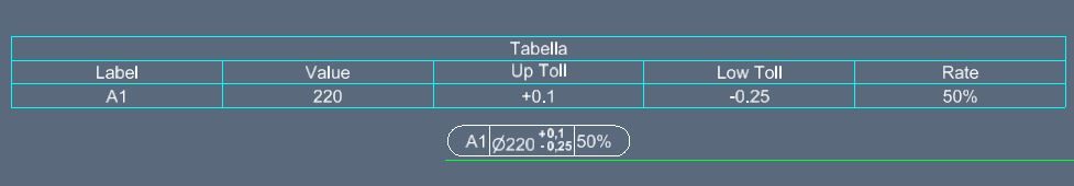

Hello, maybe you all can help me (i'm not so practice of ilogic).
I'd like to modify this Ilogic code in a way to obtain the following fields in the table.
-Columm1: the Label of the inspection dimension
-Columm2: the Value of the inspection dimension (as it already is)
-Columm3: the upper tolerance of the inspection dimension
-Columm4: the lower tolerance of the inspection dimension
-Columm5: the inspection rate of the inspection dimension
The result should be as in the followig sample.
An additional request: is there any way to make this table automatically updated each time I will insert a new or delete an inspection dimension?
Thank you so much, everybody
