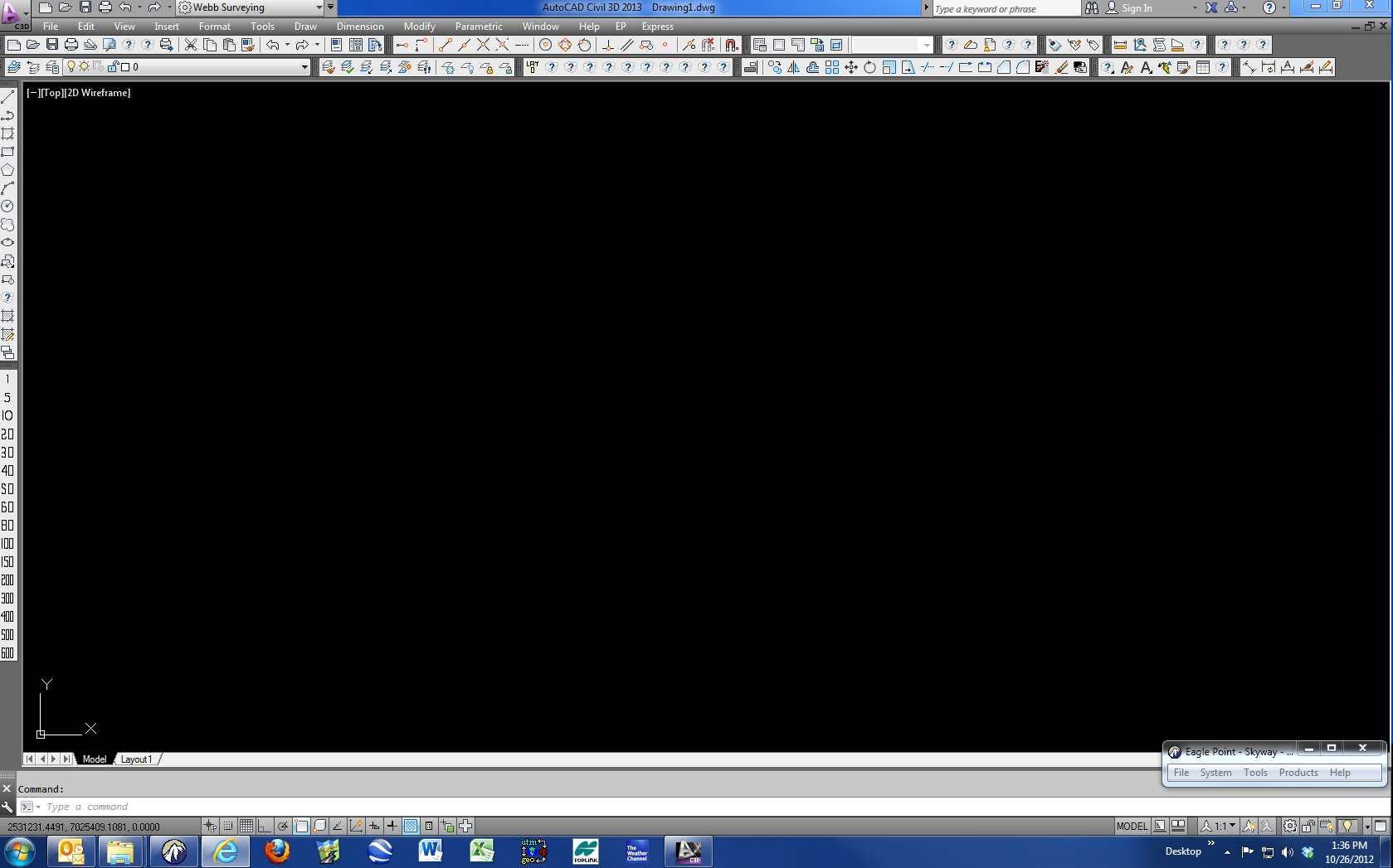

I installed 2013, used the Admigrate and the customozed menus came in just rine. Howver, some of the icons (not all) show up as question mark inside a cloud. I manually copied the icon images to the folder located in user/appdate/roaming/cg 2013/support/icon but that didn't help. SOme of the customized icons show but not others.
I seems like I remember something like this on an older version and it had something to do with memory allocation.
Is there a solution for this?
I’m curious about teh video card and video drives you have on your system.
Could you also try creating a new admin user account and start C3D 2013 with default settings and let us know if you still see those ‘?’ marks in place of icons.

When I check for updates, it says a newer version of the driver is available. Then I get an error message that it failed to update and make sure I have permission to write to the file.
I haven't tried logging in with a new account yet.
I can go to customize and see the icons for the buttons.
