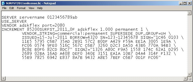

Combining License Files for a Subscription -and- Non-Subscription Product
You can also combine license files for products that are on Subscription with identential products that are not on Subscription.  This will allow the license manager to continue to use all of your available seats for that particular version.  It will only combine seats that are within the selected release.  Thus if you combined a 3 seat Subscription Inventor 2012 with a 1 seat non Subscription Inventor 2011, you would have 3 seats of 2012, 2010, and 2009, but 4 seats of 2011.  The process to combine Subscription and Non-Subscription seats are identical to the process above.  You only copy the INCREMENT portion.  For additional licenses, simply append additional INCREMENTS.  Note:  To properly combine identical products, all license files for that product must be created on the same date.

Example Alias Surface 2011 Non-Subscription File:
Spoiler
SERVER servername 0123456789ab
USE_SERVER
VENDOR adskflex port=2080
INCREMENT 85200SURFST_2011_0F adskflex 1.000 permanent 1 \
 VENDOR_STRING=commercial: permanent SUPERSEDE DUP_GROUP=UH \
 ISSUED=15-Jul-2011 BORROW=4320 SN=123-12345678 SIGN="1C46 0103 \
 11E5 5795 C6B7 35AD 2B91 57C2 B0DF A429 F59A EE1A 3005 1E9A \
 FC06 0574 9FE0 516C 567C C6B7 3260 D2C3 DA5D 43B6 770A 94B3 \
 8C8E B0F6 82CD 8DC7" SIGN2="1326 A80C F9A5 1558 174C 62A1 D295 \
 2689 02BA 16AD A408 DEF0 340E 3151 EA1A 10B7 D4A4 314F F132 \
 55B9 7825 6942 E837 8A7B 9432 A8E5 7BEF C6B7 0D1F FC06"

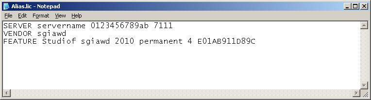

When opening a license file that uses another vendor, you will note that the license header will show the vendor used for that file.  In this example, the vendor file used is sgiawd.
Whereas this license file uses the adskflex vendor file:
If these license headers were compatible, we could simply combine the licenses as listed in the first post of this discussion above.  Since they cannot be combined, we need to create a separate service instance for them in LMTOOLS on the Config Services tab.
Before this can be done, both the license files and the vendor .exe daemons need to be copied into the same central location.  In this case, we'll copy the sgiawd.exe vendor daemon and place it in the same location as the adskflex.exe vendor daemon.  If you had additional vendor license files, you would place its relative vendor daemon in this location as well.
Once the vendor daemons and the license files have been appropriately placed, a separate license service needs to be created for each vendor license.  To do this, open LMTOOLS and go to the Config Services tab.  In each separate service from the 'Service Name' pull-down list, you would point to the same LMGRD.EXE master daemon file listed in the first box labeled 'Path to the lmgrd.exe file.'  This will ensure that each service is using the latest master daemon file and that more than one master daemon version is not being used.  Next point each service to its relative license file.  Finally, you should also give each service its own separate debug.log file.  Save each service you create, making sure that both check boxes at the bottom are checked.
With each service created and saved, you will need to start each service individually from the Start/Stop/Reread tab.  Starting one license service will only start that highlighted service.  You will need to change to another sevice to also start services for that vendor.
If there are no errors, when you 'Perform Status Enquiry' from the Server Status tab, you should see the available licenses for each service.

The top line of a license file header contains the server hostname and host id MAC address. You can append a specific port to the end of this line. For example:
SERVER servername 012345679ab 27001
In this example, the port number was specified as 27001.
Note:  Other than changing port numbers and appending valid license INCREMENT lines, the license file cannot be modified.  Server MAC address, licensed number of seats, etc. cannot be modified and will invalidate your license file.  A license file is only good on the server for which it was created.
