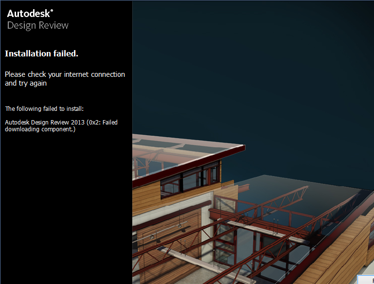

    I am on Windows 8 RTM x64. I am trying to install Design Review 2013, but the "internet connection" isn't being "found". My internet connection is fine. See the following:

    Please be aware that Autodesk products are not yet supported on Windows 8.  You should look to see if you can find a full download if available.

    Hello. This program is not supported on Windows 8, so it may not be usable in your environment. There is an alternate download method, however. I have a link for you hat describes this here:

    David - that worked perfectly. I'm up and running, thanks very much! -David

    Hmm, but I'm getting the same error message... on a workstation that's WinXP 32-bit. I've tried the alternative download option as well. Any other ideas what I can do?

    Hello. I would uninstall the program and wipe the residual folders for Design Review. There could be residual traces from a failed install.  First, run the MS Fixit utility and try to uninstall Design Review if it lists in this program.
    http://support.microsoft.com/mats/Program_Install_and_Uninstall\
    Next, look for and delete residual traces that may be there. They will be clearly named and in a variety of places:
    C:\Program Files\Autodesk\
    C:\ProgramData\Autodesk\
    C:\Program Files (x86)\Autodesk\
    C:\Users\All Users\Autodesk\
    C:\Users\**YOUR USERID**\AppData\Roaming\Autodesk\
    C:\Users\**YOUR USERID**\AppData\Local\Autodesk\
    After all this is clean, make sure you have the MSI installer on your system.
    http://www.microsoft.com/en-us/download/details.aspx?id=8483
    Log in with an Admin account, turn off Windows UAC and Antivirus and give the install a go.
