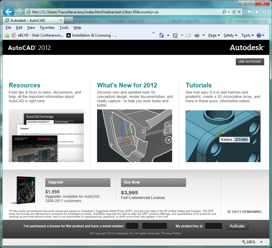

    Registered: 01-14-2005
    Re: AutoCAD 2012 Trial Startup Problem
    02-09-2012 01:52 PM in reply to: fatfingers
    Crazy thought, but unzip this corrected index.html file onto your desktop.  Then in the root of your Windows User Profile under your username create a folder called enu and paste the file there too.  Then run the one on your Desktop and allow active content when prompted.  Then replace the redirect line with this one:  ?redirected=1&d=30&country=us  and hit enter.  This allowed me to click the run link.  Might work for you too.
    My Top Contributions to the Discussion Groups:   Send TravisNave a Private Message
    FLEXnet License Administrator | MSI Cleanup Utility | .NET Framework Cleanup Tool | IPv6 NLM Fix | adskflex.opt Options File | Combining .LIC Files | Search Autodesk Discussion Groups
    Please give Kudos or Accept as Solution  If my post was helpful, please give Kudos and/or mark the Accept as Solution button(s) below. Thank you!
    Member
    fatfingers
    Posts: 5
    Registered: 02-09-2012
    02-09-2012 02:17 PM in reply to: TravisNave
    Ok I did what you asked.  I have to click on the index.html first, allow active content, then start AutoCAD then wait for another LMU.exe page to display (shows tutorials whith the run autocad button in the right hand corner) then click that run button.
    So in short the software is running now.  Abit of a round about way to start it though.
