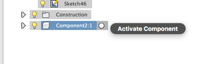

Hi Nathan apologies if this thread is no longer active.
I am trying to figure out if it is possible to move the origin point of a component. For some reason all of my origin points are offset from the components they are attached to.  I'd like to simply move the point so that it is in the middle of each component.  The reason I need to do it is to simplify the process of orientating the components to each other in the animation workspace.
Many thanks
Matt
Message 9 of 10
@ViewingSoftware No worries! I'm always happy to help.
A couple of thoughts on this one.
1. Are you activating components when you edit them?
The only reason I mention this is it is helpful to do this. It simplifies the timeline and greys out other components and bodies. In general, it just makes it a bit easier to modify a component.
2. If you use the Move/Copy command and move a body (not a component), you will move the body relative to the origin of the component the body is located in. The below screencast may help clarify what I'm trying to say here. Take a look and let me know if it helps!
Nathan Chandler
Principal Specialist
Message 10 of 10
Sorry for the delayed response. Many thanks for the suggestion. I suppose I was hoping that there was a retro-active way of changing the axis / origin of a component. I will certainly be careful to ensure that I am more aware of origins as a create components in the future.
