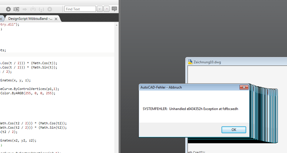

    And because of teh crash: I get a crash after runing a script many times. Error:
    but: I don't have SP1 für ACAD Mechanical 2013 installed! Will install today.

    because of the crash: When I shade the drawing und run the script again (1-2 times) I get the system error.
    Same problem after applying SP1 for AutoCAD Mechanical 2013.

    Sorry to know that you are facing some crash while running design script. A new update (version 0.3.24.5026) for DesignScript is available, hopefully this update fixes your crash issue.
