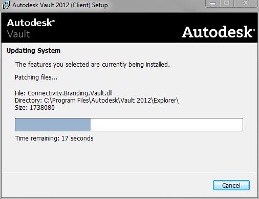

Installed Vault 2012 SP1 on vault server without issue, but when installing the client version, we're getting this:
It's occuring at this point:
UAC off
Windows updates installed
Antivirus disabled
What should we try next?

Hi Energymech,
We found in another case that this is a different problem than the erorr with the "Connectivity.Branding.Vault.dll" and not as widespread. ie we are not getting as many reports of this issue
After, uninstalling Vault Professinoal 2012 and AutoCAD Mechanical 2012, deleting their respective C:\Program Files folders and reinstalling them, it was possible to re-apply Vault 2012 Update 1 successfully. So can you try that to see if works? We are still looking into that but this might be the quickest solution for you.

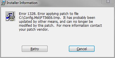

So, I have tried everything on the list short of uninstalling and re-installing Inventor Pro 2012 to get SP1 to load. I am having crashing issues with the base software. I keep getting the error 1328 during the install.  I have replaced the dll file as directed.
Please, for the love of god, tell me what I have to do to fix this.  Since the Vault 2012 install has migrated the files over, I am out of options.

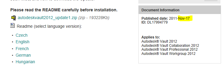

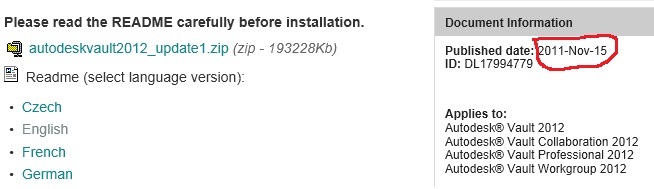

I was just at the Autodesk site for something else and noticed this.  Looks like the files were updated today too?  Last picture posted showed 11/15 now I see 11/17 so were you looking at the files contained in the 11/17 version?
Message 34 of 50
Greatwhitenorth
Yes, it was the November 17 version.

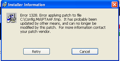

And guess the result when installing this "new" sp1...

Hi All,
I just wanted to share our findings so far regarding this issue. Our investigations with customers reporting this issue to us directly have revealed that this appears to only be occuring on plain Vault 2012 clients installed from the Product Desgin Suites and Factory Design Suites. There are reports of different install issues with higher versions of Vault but these concern different dlls and are considered to have a much lower impact. We've worked around those other install issues when they have been reported to us.
So this issue affects a smaller subset of users meaning that pulling the update would prevent Vault Workgroup users and above of the benefits of the Update. Releasing a second update 1 would also result in a two tiered patch level for users who may have installed the patch already from sources other than PDS and FDS. We want to avoid that.
For those still affected by this issue with Update 1, we're still working on delivering a solution to you and we hope to have some good news to share shortly. We appreciate your continued patience and support.
Lastly and hopefully to clear up any confusion, the changed date on the Update 1 for 2012 page observed earlier on this thread, indicates that only the web document changed. Autodesk has not released a new Update 1.
