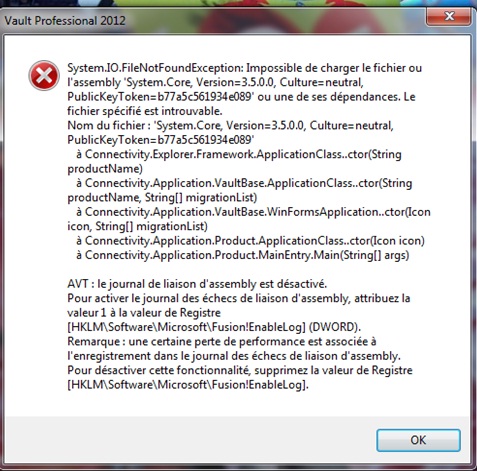

    My problem is : When I want to open VAULT, the next message appear : erreur_vault.jpg
    Is somebody know this problem ?
    Thanks for your help.

    I don't read french, but I can tell by looking at this that it is some sort of registry error.  It appears to be an installation issue of some sort.  Do you have an IT person at your company that can look at this?

    I don't know what the problem is.  I think we need more information about what you installed and how.  Would it be possible to translate the error screen?

    I have found the same error but in English for you.
    What is strange, it's that this message is appeared after one month of the installation...
    Also, AUTOCAD LT is installed on the computer... Perhaps a compatibility problem between them.

    This looks like .NET has either been corrupted or uninstalled.
    Try doing a repair-install on .NET 4.0 and see if that helps.

    You had reason. It was .Net Framework which was broken. But not the 4.0, it was the 3.5.
    I'm forced to activate it  in  "Turn Windows fetaures on or off" and to check "Microsoft .Net Framework 3.5.1".
    Thank you very much to have put me in the good way !
