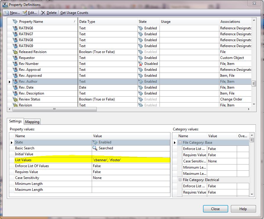

I've fixed the issue I was having with the revision table not working at all... so now I can say that for your situation, the best thing to do might be to create a User Define Property like Revision Author.  I did this, and set it as a list value and filled the list with the names of all the users as I want them to appear in the revision block.  I did the same with the approving engineer.  I also have UDP's for the revision description field and the revision date.
Here is a screen capture of the Rev Author.  What I do is when the State has been changed from Released to WIP, I edit properties on the file and change these properties... it will set them for the current version and leave the settings for previous versions intact.  If you need more help with this let me know.  I'm just happy I got it working again.

I'm saying that instead of using the actual username in your Vault revision table, create a User Defined Property... then it will show up however you want it to.  You just have to map the Revision Table to that property.
