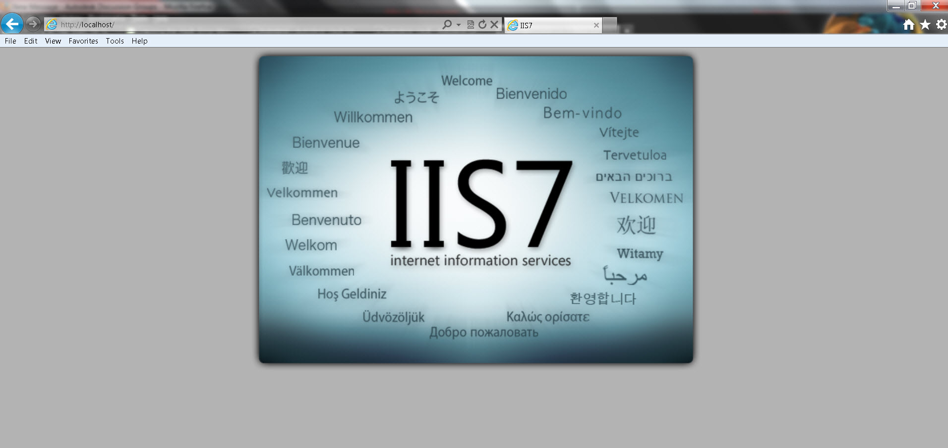

    This what i have now :

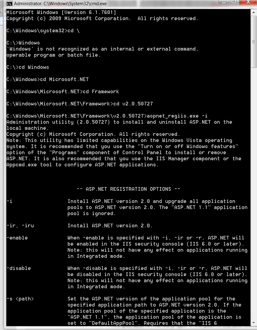

    Dan.M
    Posts: 526
    Registered: ‎01-19-2009
    Re: ASP error
    05-07-2012 10:51 AM in reply to: helmartins
    I did as you indicated but this is what happened ::smileysad:

    Product Support
    Andy.Spivey
    Posts: 350
    Registered: ‎08-12-2010
    Re: ASP error
    05-07-2012 10:53 AM in reply to: Dan.M
    Dan,
    Please right click on the static txt file and select browse - from the second screen shot, you were attempting to connect to http://localhost80 instead of http://localhost:80

    Active Contributor
    Posts: 38
    Registered: ‎04-16-2012
    Re: ASP error
    05-07-2012 11:00 AM in reply to: Dan.M
    Try these
    2. Type the following command to enable the 32-bit mode: cscript %SYSTEMDRIVE%\inetpub\adminscripts\adsutil.vbs SET W3SVC/AppPools/Enable32bitAppOnWin64 1 3. Type the following command to install the version of ASP.NET 2.0 (32-bit) and to install the script maps at the IIS root and under: %SYSTEMROOT%\Microsoft.NET\Framework\v2.0.50727\as​pnet_regiis.exe -i
    (if that fails try %SYSTEMROOT%\Microsoft.NET\Framework64\v2.0.50727\​aspnet_regiis.exe -i
    4. %SYSTEMROOT%\Microsoft.NET\Framework\v2.0.50727\as​pnet_regiis.exe -GA ASPNET
    (if that fails try %SYSTEMROOT%\Microsoft.NET\Framework64\v2.0.50727\​aspnet_regiis.exe -GA ASPNET
    5. Make sure that the status of ASP.NET version 2.0.50727 (32-bit) is set to Allowed in the Web service extension list in Internet Information Services Manager.

    Dan.M
    Posts: 526
    Re: ASP error
    05-07-2012 11:09 AM in reply to: Andy.Spivey
    if I click browse on the txt file nothing happens.
    if i write with :80 also I get page not found.
