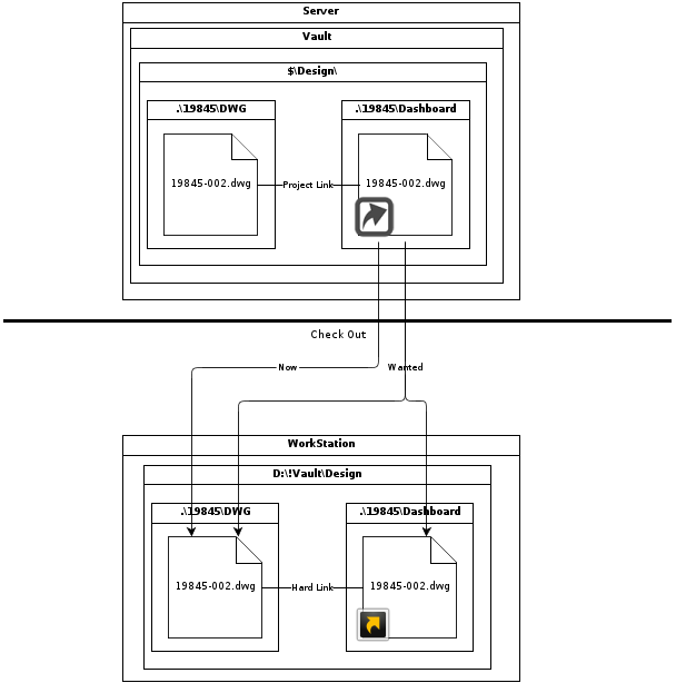

    Please, consider possibility to check out Project links as a Hard links (for NTFS).

    by MiWaNiZa Moderator on ‎08-20-2012 07:08 AM
    That's right.
    While I'm creating link A' (in F' folder) to file A (situated in the А folder) and checking it out (from the Inventor, for example), the file in my workplace appears in folder where A file is located, instead A' location.
    It would be logical to download A file and A' link to it. And then link them using hard links. Example diagram is shown below.

    by Employee john.stewart on ‎08-27-2012 02:59 AM
    This feature would also support  and allow Buzzsaw Sync to place the published linked File in a equivalent Dashboard folder in Buzzsaw.
    A good example is Transmittal Files that would be shared with specific Suppliers/Contractors and Customers. Current Buzzsaw Sync requires the Buzzsaw Admin to provide access to Suppliers/Contractors and Customers at the DWG folder level instead of the Linked File Folder location
