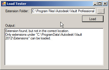

    Well, I tested the 'Load Tester' from Doug, and the result is:
    :mansurprised:
    I will try to uninstall and reinstall VP2012 Client in ProgramData...
    If it is this, it's not normal.

    I wouldn't suggest reinstalling the Vault Professional client. Vault Explorer should stay installed, with all of it's program files in the Program Files location that it defaults to. Only your extension should be deployed to "C:\ProgramData\Autodesk\Vault 2012\Extensions" as described in the readme file.  This folder is not created during the Vault Explorer install and will not exist until you deploy and extension and create it yourself. The error you're seeing in the Load Tester means that you have deployed your extension to the wrong location. All of the files from the sample's bin directory should be copied to "C:\ProgramData\Autodesk\Vault 2012\Extensions\JobProcessorApiSamples". You should create this folder structure if it does not already exist.
