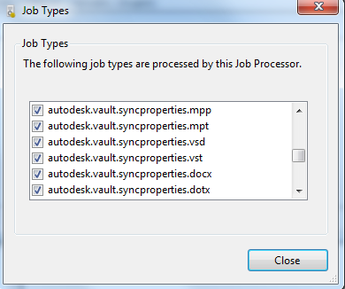

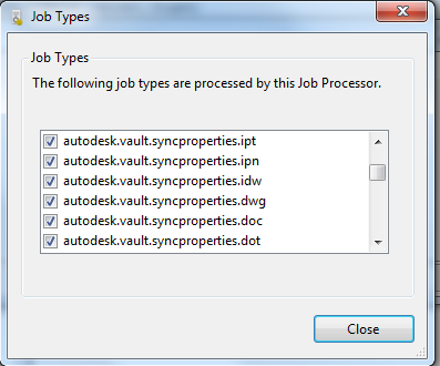

    on the local computer the jobserver is running? and shows like this
    on the server the jobserver is running also and shows this.

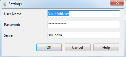

    i setup a jobserver user "VaultJobServer" that i typed in to the jobserver as the user to run the jobserver?
    what do i do wrong?

    What you need to do is please follow the instruction explained in the readme file in Job processor sample. The job type is missing in your job type list (see your previous pic), this means that job has no jobhandler so it won't be hanlded.
    No need to stop/assume job server. I did't say you should do that.
