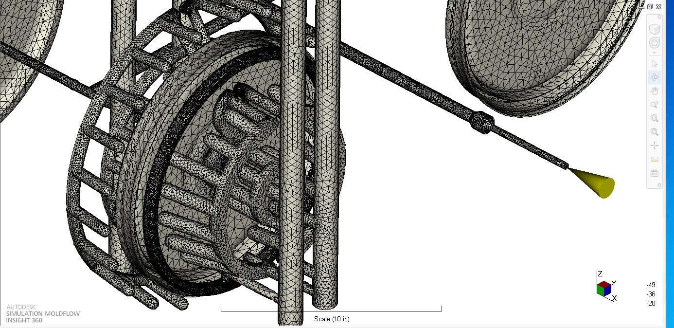

Hi everyone,
I have recently started using Moldflow Insight, and I am struggling to find the correct workflow for a specific issue I am facing.
I am analyzing a mold for a cylindrical part. The central core of the part is in contact with two concentric mold inserts (as shown in the attached image). Additionally, there is a bubbler (fontana) located at the center of the innermost insert. My goal is to evaluate the impact of using different materials for these two inserts on the total cycle time.
I understand that I need to use the COOL(FEM) solver and generate the mold mesh by following the standard two-step procedure discussed in previous threads. However, I am unsure about how to properly manage the CAD components and their mesh generation.
Here is what I have tried so far:
I imported the .step files for each component (the part, mold insert 1, and mold insert 2) and meshed them individually as 3D elements.
I then intended to assembly them, model the cooling circuits using 1D beam elements, and finally generate the 3D Mold Mesh.
Unfortunately, with this approach, the final mold mesh generation fails. I suspect the issue is related to the intersection between the bubbler (beam) and the 3D insert.
As a workaround, I tried keeping the central insert as a Dual Domain (DD) mesh. In this case, the mesh generation succeeds, but the solver stops during the analysis, throwing an error due to the intersection between the cooling circuit (beam) and the insert elements.
Should I modify the CAD file of the central insert to include a physical hole for the cooling channel before exporting it to .step, rather than exporting it as a solid block? Or is there a different, more effective workflow I should follow in Insight to handle this setup?
Thank you very much in advance for your help!
