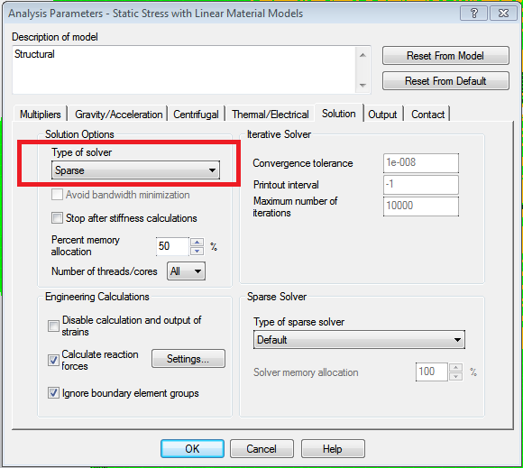

    I have a similar problem with a flange analysis.  I have an Instrumentation Flange with multiple ports in the center of the flange.  I have fixed the outer bolt holes and applied a pressure on the opposite side of the flange on the center panel where the ports are.   When the Instrumentation ports are in a circle around the edge of the center panel the analysis runs and gives reasonable results.  I go to analyze a second configuration that differs only by having 8 Inst. ports in a circle and one in the center instead of 9 Inst. ports in a full circle around a solid center and the results are zero, no stress, no displacement.
    Any thoughts?
    Please use plain text.
    Employee
    Posts: 398
    Registered: ‎05-06-2010
    Re: flange solid 3D and moments
    05-04-2011 04:45 AM in reply to: mirred
    The direct reason is the equation solver (AMG) didn't get an appropriate solution back.
    I'm not sure why this happened.
    The solution for your problem is to change the equation solver from "automatic" to "sparse", which locates at Analysis Parameters -> Solution ->Solution Options -> type of solver .
    If this response answers your concern, please mark it as "solved".
