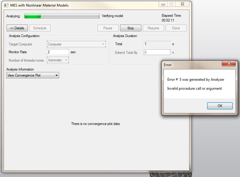

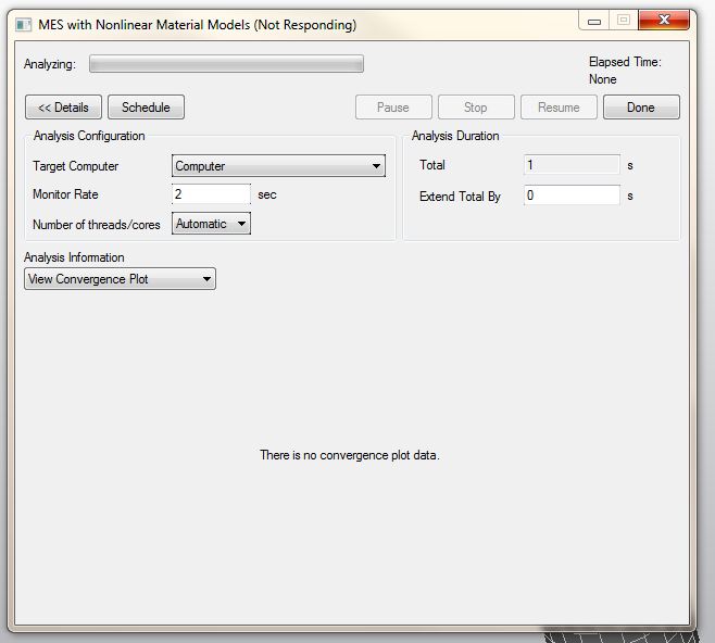

    As you can see in the first image it crashes or hangs straight away when the Analyze window pops up.
    I then found a hanging process in Windows process explorer. I hit resume on gcontact.exe and then got the error you see in the last picture. There is some progress on the status bar however.
