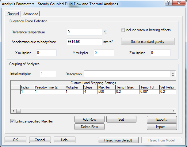

Thanks, John.  As a followup, you did your timesteps differently than I did mine.  For the ascending, you went with an initial of 0 and in your load case you specified a multiplier of 10, and I'm assuming in the combined analysis parameters window you told it that you wanted 4 steps?
I set mine up as follows:
and
I was under the impression that by setting the number of steps to 4 my load cases that were output would be the 4 load cases I had set up in the fluid parameters window, i.e. 32, 16, 8, and 4.  Is that correct, or am I getting some weird interpolation between them?
Using Autodesk CFD and Fusion 360
AstroJohnPE
My understanding is that your example analysis should have simulated 1 second of time because the analysis duration is controlled by the Coupled analysis parameters. You can confirm or disprove this by checking the times shown in the Results environment.
But with your setup, you have asked for 4 time steps between time 0 and 1 sec (the first row in the Coupled analysis parameters spreadsheet). The coupled load (buoyancy) is constant because the initial multiplier and the multiplier at 1 second are 1.0. The Fluid Flow analysis parameters indicates to ramp the fluid loads (velocity, pressure, etc) from 4 to 32 during the first second. The rows after 1 second should have no effect on the analysis.
So your results should be
Time  |   Multiplier
0         |        4
0.25   |       11
0.50   |       18
0.75   |       25
1.00   |       32
Hope this helps.
