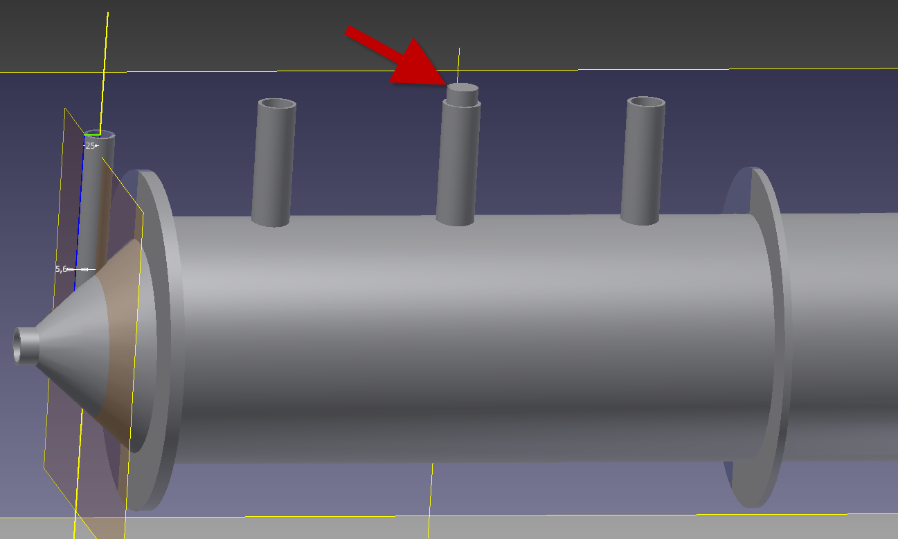

    hello.. the easiest way to do it is to create "caps" on all of the openings. You can either do it as a multi-bodied part or as an assy. Just dont merge them with the heat exchanger. When you launch into CFD, it will automatically create the fluid part. The idea is that you want to create a water-tight model and CFD will "fill the void"
    here is an image of a typical "cap"

    Yes.. But, often the caps are used as the part of the fluid space. Often times in CFD, an extension is used for the fluid at the inlet and outlet. to place a boundary condition away from the actual inlet/outlet.
    Take a look at the attached. If this isn't clear, you may want to contact support and they can walk you through it.
