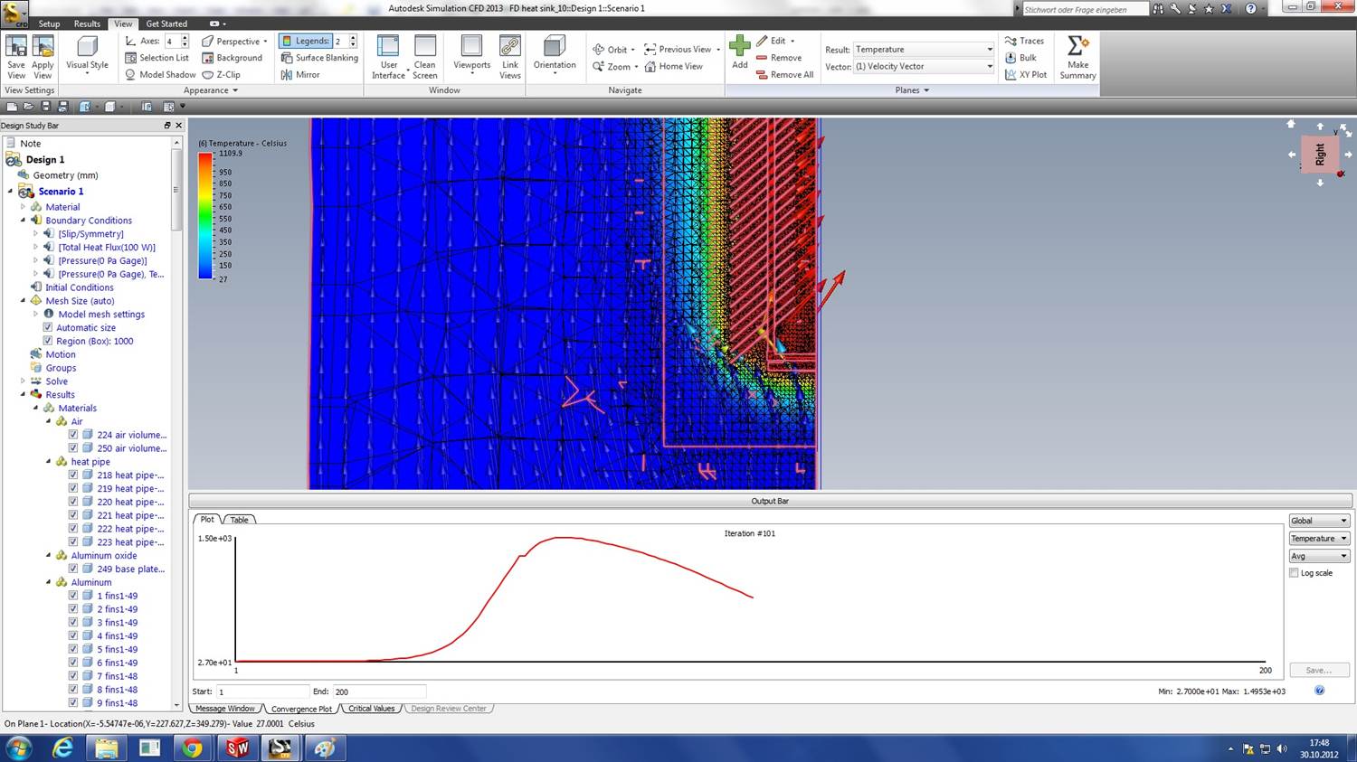

    Overall the mesh doesnt look too bad around the device. The one aspect that I was mentioning in my previous comment is to add a refinement region above the device (vertically). As we are dealing with subtle density differences to generate the flow field and develop above the device, we will need a mesh to capture these details.
    In the image below I've outlined where you would place your refinement region (in CFD) and refine the mesh a bit tighter.

    Dear Apolo and Royce,
    Thanks for the support. Yes, it worked, but struck with another issue.
    Some inputs from a new user: it was difficult for me to locate a specific surface/volume within th emodel to locate meshing error. I had a call with your support team to identify this.
    your support team asked me to use Royce method. i am trying it and the results are promising. Thanks again for the support.
