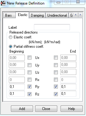

    1) using the truss bar option without any bar release, getting the same instability type.
    2) using bar release in X,Z direction only , same instability.
    Trying to solve the roof structure in 3D, how important is the bar offset of the transversal beams (purlins) in this case?
    Do you recommend roof as cladding, and wind load applied on it?
    Truss bars are similar to bars with pinned end connections.
    For a 3D structural roof you should keep the chords as continuous (see the attached model). Otherwise you can consider use of partial releases.
     Personally I would not define any offsets.
    This is one of the options but this is going to be your decision :smileyhappy:
    P.S. I have corrected the error of not applying truss bar attribute to one line of posts in the attached model too.
