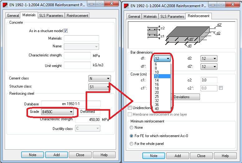

why for shell and plate reinf. max bar diameter is 16mm???

It depends on material :
