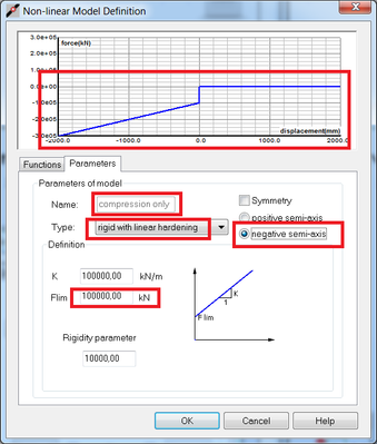

I want to know how to define a non-linear release that is compression only. Robot seems to make it tension compression as shown.  Any advice?

3/ you can also use releases with non-linear model as shown in your post - but in such case it will be necessary to define different stiffness (very high in one and zero in opposite direction) for positive and negative semi-axis

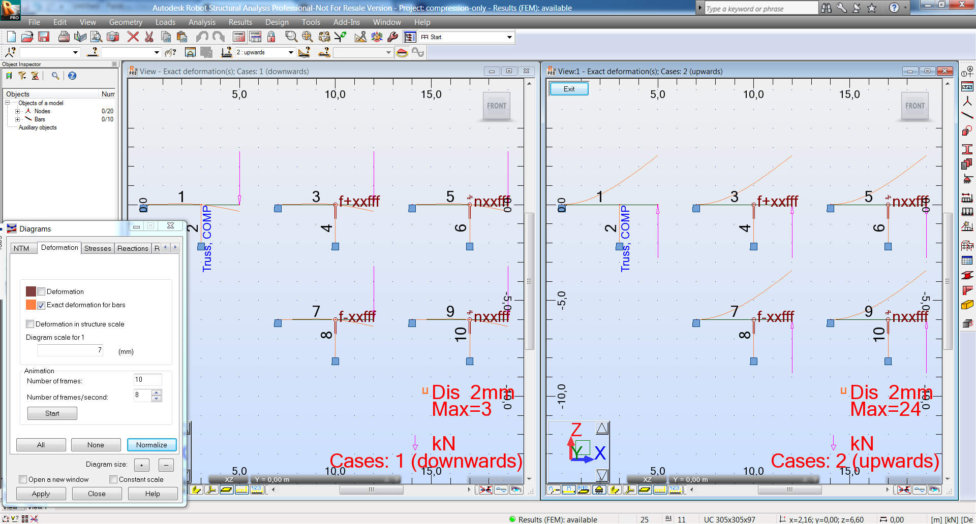

attached file containing very simple model of compression-only vertical member which supports horizontal cantilever.  It is repeated 5 times and model in various ways :
1/ bar 2 - modeled by compression-only truss member
2/ bars 4 and 8 - modeled by unidirectional releases defined on the beginning (bar 4) or on the end (bar 8) of bar
3/ bars 6 and 10 - modeled by non-linear releases defined on the beginning (bar 6) or on the end (bar 10) of bar
It contains 2 load cases with vertical load on the end of cantilever downwards and upwards - see the screen capture below:
Non-linear model of release is defined as zero stiffness in one direction (positive semi-axis) and "rigid with linear hardening" with very high Flim force in opposite direction (negative semi-axis) - see the screen capture below:

very detailed thanks a lot Smiley Happy
