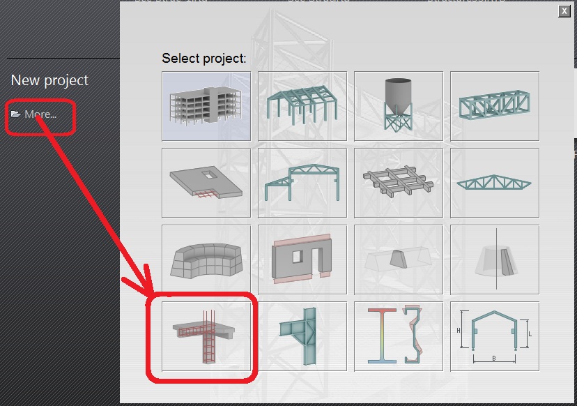

    Have changed the drive names but I still can't progress past the project screen
    Have you seen crash report window where you can specify e-mail address and report crash? If so please register crash specifying your e-mail address.
    Try this: open RC design, if there is no crash please go to Preferences and change OpenGL acceleration, then restart robot and check.

    Error report registered and SP2 installed. Still not able progress any further, when accessing a project type it tries to load the model space but then stalls and error report pops up.
    THx, we are checking it.
    The same if you select RC Element stucture type?
    The crash is generated by ATI graphics card driver. PLease update your graphics card driver to the newest one.

    Thought I should clarify so that you don't think im trigger happy, I logged two reports, pre and post SP2 install, not sure if that helps.
    Yes tried going through RC element structure same result, sorry meant to stipulate.
    Analyzing them we found that crash is caused by ATI graphics card driver.

    Peter,
    Try this structure type, Tools \ Preferences,  then turn off OpenGL in Robot.
