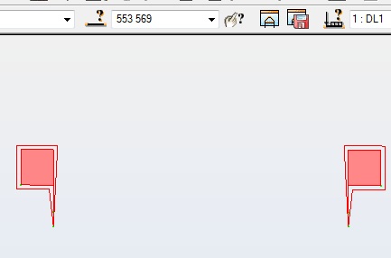

    Igor

    Dear Rafal, thanks a lot! Unfortunately, I can't receive meshed files (please, find reasons in Private)
    Yes, this element with incorrect geomenry (it was created like wall in RST, than opening with width = wall's width, so invalid contour occured).
