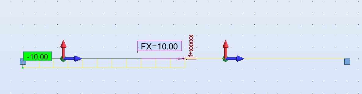

    Product Support
    Posts: 2,543
    Registered: ‎04-26-2010
    Re: Unidirectional release
    02-20-2012 06:14 AM in reply to: SICAD
    Take a look below, no compression (yellow diagram , Fx force) on right hand side beam due to release Ux+ defined at the beginning of this bar, tension in left bar

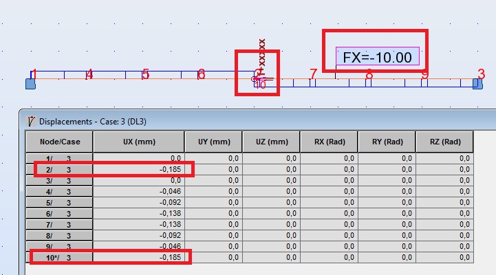

    I think the problem is solved:
    let's take a look to the central node; the situation should be
    this means that the 1st node of the 2nd bar is free in Ux+, while the whole bar is free in Ux-.
    Due to the fact that there is a DSC element (is it correct?), the node and the bar move in opposite directions.
    So the "beginning node of the bar element" (User's guide) is the node 1 of my sketch, while I intended that it was the "new node" of my sketch (they can move in opposite directions).
    Giorgio

    Product Support
    Posts: 2,543
    02-24-2012 04:11 AM in reply to: SICAD
    DSC algorithm creates connections between phisical node (on your screen capture node 1, on mine (below) node 2) and calculation node (on your screen capture "new node", on mine  - node 10).
    In our situation (unidirectional realease UX+) such link does not exist between these two nodes only in UX+ direction so node 1 (or 2 on my example) can be displaced but your "new node" (mine node 10) remains in the same position.
    In case of opposite direction force these nodes will act toghether:
