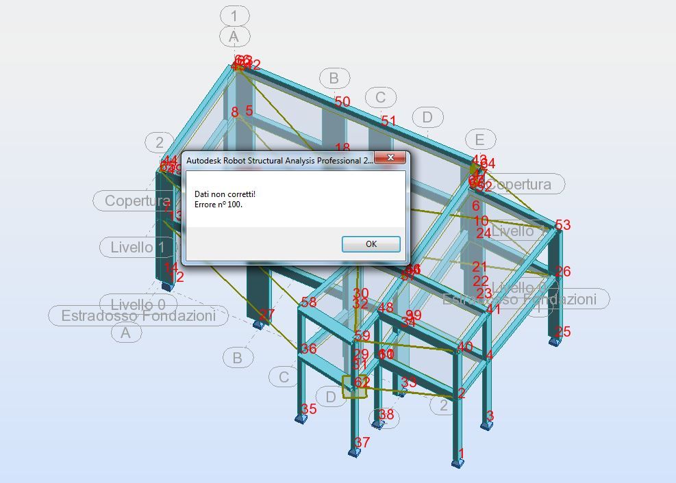

    Hello, I have two problems:
    -as I can orient the reference system more panels in the same direction automatically?
    -in a model I find this problem, but I can not figure out where the model is wrong?
    (i attach the file)
    Cattura.JPGCatra.JPGthanks
    Andrea
    I will check the model but take a look at this thread http://forums.autodesk.com/t5/Autodesk-Robot-Structural/Error-Nr-100/m-p/3602456/highlight/true#M713...
    Rafal Gaweda
    Product Support
    Autodesk, Inc.
    Please use plain text.
    Product Support
    Posts: 2,500
    Registered: ‎04-26-2010
    Re: Two problems
    09-24-2012 01:51 AM in reply to: RG_Adsk

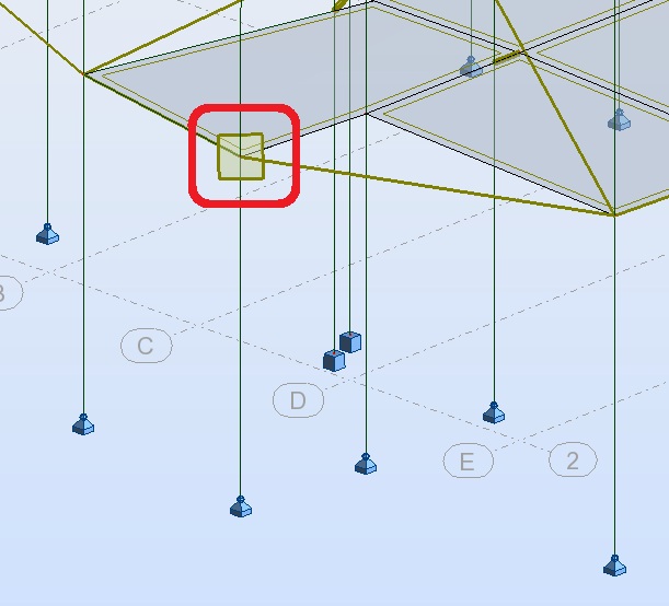

    It is caused by not connected rigid link and some nodes not connected to bars located on claddings egdes \ corners.
    Corrected file attached.
