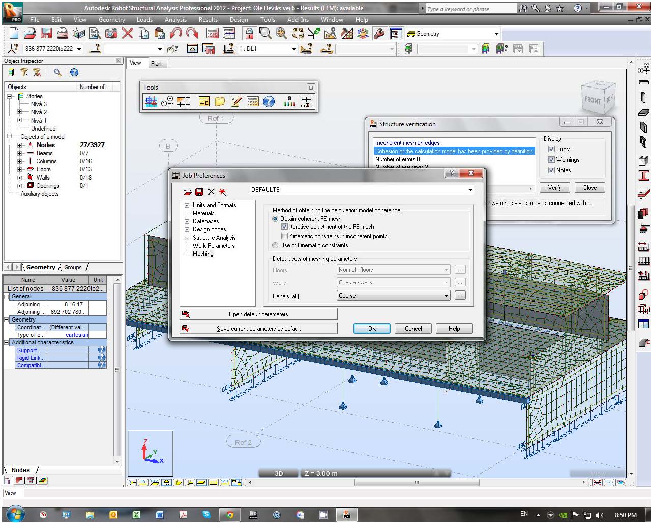

     Just choose some different mesh options until it looks like a nice clean mesh.  You have to balance density of mesh with accuracy of results and calculation time.
    You'll probably find if you just run the analysis and then do another verification you will get a warning about incoherent mesh and kinematic constraints.  Try setting the mesh options in job preferences to iterative, rather than kinematic.

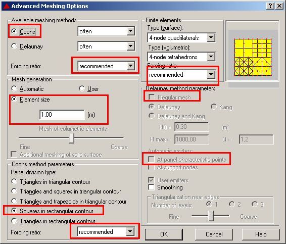

    Make settings like this:
    Turn off kinematic links, use Iterative adjustment
    (gryed out field settings also important ; element size  - up to you)
