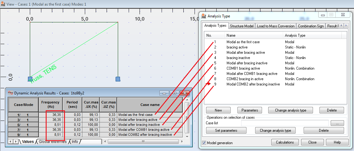

    answers to your questions illustrated by attached very simple model (4 bars) and screen capture made for it:
    1. It is either simple load case or load combination.
    2. For simple and regular models it is often possible to find loads resulting in all tension-only bracings working. For sophisticated and unregular models it is often practically impossible - for your model received by private message:
    - using selfweight upside-down (in Z+ direction) resulted in about 30% of tension-only bracings still inactive
    - using negative temperature TX for all tension-only bracings (equal value for all of them) resulted in 2 such bars still inactive
    The simplest solution to obtain dynamic analysis with no tension-only members disabled is to define modal analysis as the first load case - before any static load cases. Load cases and combinations can be renumbered in Load Types window (Modify button)
    Just a reminder: if no tension-only members are disabled the stiffness of structure is overestimated.
    If this post answer your question please click "Accept as Solution". It will help everyone to find answer more quickly!
