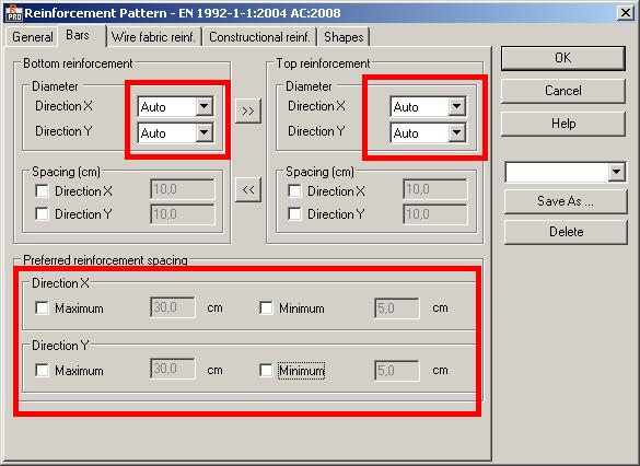

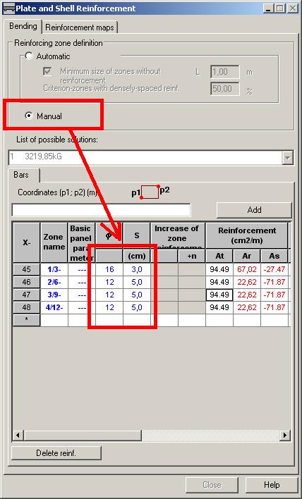

    I trying do a slab analysis as per the attached Robot model. When I do the requried reinforcement calculation, I get some red coloured error message (see the image file RF.jpg).
    1. How can I get out of this error message and get the correct results?
    2. If I want to treat this slab as a discontinuos slab, what sort of releases I need to apply to the edge of the slab?
    You have to reinforce this slab corectly. It is not possible to cover 94cm2 by fi12by5. You can use 12s but with spacing 1cm but 1cm is less than 3,7cm <- code limit.
    Change rebar diameters and or create zones manually etc

    Athi_uk wrote:
    Can you please let me know about reinforcing correctly?
    Generate \ modify generated reinforcement \ zone to obtain Ar > At
    1. Automatically:
    2. Semi manually
    - generate zones automatically and set reinforcement and spacings manually for each reinforcement layer:
    3. Manually - creates zones and distribition manually (similar to screen capture above)
    i.e what bar size? what spacging limits? minimum bar size?
    Your decision + national code requirements
