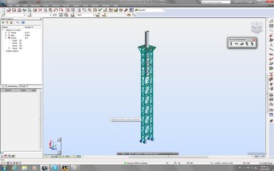

    Greetings Everyone.
    Im creating this model of a steel structure wich holds a circular gas pipe.
    At first i created the circular shape having 4 points in common at the base of the pipe and it seems to work out good. however in the different upper lvls this gas pipe is uspposed to have a "guide ring" wich allows it to expand on its edge (Zdir).
    I thought this could be done by using rigid links, or compatible nodes, however the meshing model of shell pipes creates only six edges, and it seems not working properly, moving the pipe by itself.
    Hope u can solve this issue for me Thx.

    I'm not sure if I understand you correctly but you can try to define short and rigid bars that connect the gas pipe with the rest of the structure with vertical displacements and rotations released at the side which connect to the pipe.
    I don;t know how you created the pipe (extrusion, revolve) but this is when you can decide on the number of divisions of the pipe.
    If this is not good enough send the model and the sketch that illustrates how this looks like in reality.

    here is the ilustration, i cant attach model because its 1mb. is there other way¡?
    the idea is to fix tue pipe at the botton, using the upper floors to restrain x and (blue rings).

    Looking at the picture I  would model something like that.

    Is there any way to change the number of sides of the cirsular shell after extrusion?.
    The post is already anwered im just curious.

    Example movie: http://screencast.com/t/NP7rC3G6tXRb
