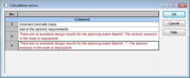

    Can ( SEIS. Joint X + ) be de-activated even with seismic dispositions checked? It seems to cause very high moments in the column. I know it is a requirement of some codes, but would like to be able to see what is required from purely design considerations vis-a-vis capacity design considerations.

    The only way is to calculate the column before calculations of beams adjoining to the node above the column. There will be no results from beams so a warning will appear as on jpg below (No. 2 and 3). The rest of seismic analysis should be done.
