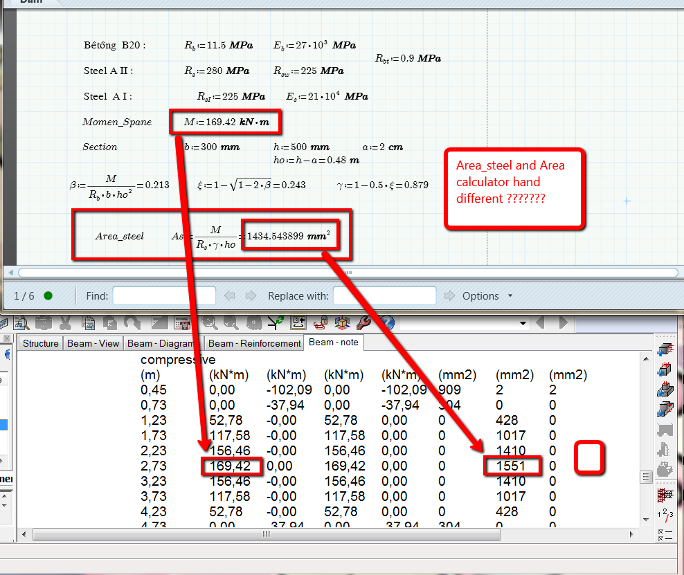

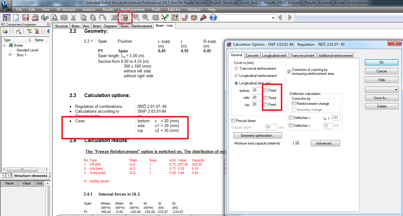

    Hi. I is prolem
    Question 1. picture 1
    Conver c of picture right ???
    Question 2. Pticture 2
    Why c=0????
    I attment file picture under.
    thanks
    Please use plain text.
    Product Support
    Artur.Kosakowski
    Posts: 2,771
    Registered: ‎12-17-2010
    Re: Area steel ?
    12-27-2012 12:39 AM in reply to: A.wikipedia
    Looking at the rtd file you sent the cover is displayed as 20 mm. Could you sen the rtd file where you have it displayed as 0 mm in the calculation note?

    Distinguished Contributor
    Posts: 121
    Registered: ‎08-03-2012
    Re: RC BEAMS - SNIP - Area steel ?
    12-27-2012 02:53 AM in reply to: A.wikipedia
    Is here.
    12-27-2012 03:19 AM in reply to: A.wikipedia
    Thank you for the file. As far s I can see the 0 values are displayed when covers are locked. As you have the reinforcement frozen calculations of the beam will not change it therefore you can unmark these check boxes to have the correct value displayed in the calculation note.
    Posts: 121
    12-27-2012 03:50 AM in reply to: Artur.Kosakowski
    Thank Artur.
    But If I not Fixed. As (robot) > As( hand).
    Product Support
    Artur.Kosakowski
    Posts: 2,771
    12-27-2012 03:57 AM in reply to: A.wikipedia
    1. Calculate beam with the fixed covers
    2. Edit the value of covers in the calculation note or
    2a. Freeze the reinforcement generated for the fixed covers
    2b. Calculate the beam with frozen reinforcement again to have the 20 mm cover displayed in the note.
