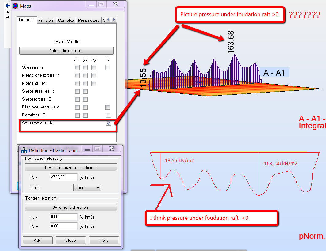

    I is prolem, I think Pressure under foudation raft >0. Why results Pressure Robot <0 ???????

    Because it's a reaction?  Under vertical load, a pinned column will have +ve reaction.  So under applied load, a soil will have a +ve reaction too?

    So now I have to do to pressure under the foundation raft <0 ??. This is an image of my model .

    As you are supposed to tell in which direction the uplift is possible you should set UZ+ rather than UZ- (at least for a typical building :smileyhappy:).

    i selection U+.

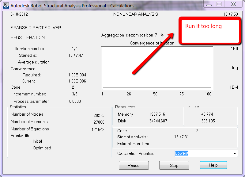

    But why Run it too long, is there a way to make it run faster???

    Hi. i is prolem.
    How do I know choose U + or U- ??????

    You can try to use the multi-threaded solver.

    1. Check what is the orientation of the local Z axis of the panel
    2. If you want to allow the panel to move (be uplifted) in the direction of the positive Z axis then you select UZ+. Otherwise UZ-.

          "You can try to use the multi-threaded solver."
    Sorry I do not quite understand, can you give me an picture example.
    thank Artur

    10-08-2012 02:57 AM in reply to: athurD
