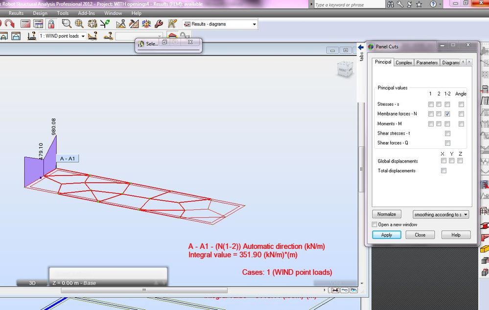

    I am trying to model a shear wall panel for stability and checking concentration of stresses at the corners.
    Any chance of some tips on how to interpret results from ROBOT?
    Also, are you aware of any information (guidance, examples) available online?
    I think I understand how to extrapolate max compression/tension forces but I am not too sure about shear (for examples in coupling beams above openings). Should I be looking at max values of 5N/mm2 (based on BS) and hope to design shear links to cope for values above vc?

    11-13-2012 04:50 AM in reply to: pp2008
    Pawel
    Thanks for taking time to create example
    I have tried to follow but could do with a check..
    I have attached a screen shot for what I think is the total shear at the coupler interface - however I cant get the clear diagrams as shown in yours.
    If I could email reduced model to check whether I am in right direction?

    11-13-2012 05:46 AM in reply to: robmirgga
    Roberto,
    shear force can be obtained as an integral of NXY, where NXY is in-plane shear force  in some coordinate system and cut is defined along the XX or YY direction of this coordinate system.
    In your case you have displayed N(1-2) which is a maximum in-plane shear force which is "coordinate system independent" - i.e. in each point of panel it can be in different direction because it is related to principal directions of 2D state of stresses. That is why integral of this value in general case has no physical meaning.
    If you want to send your model no problem. To reduce the size please use "Save as" to different name and without results. Then compress to ZIP.

    11-13-2012 06:19 AM in reply to: pp2008
    Thanks Pawel
    Much clearer, however I still don't think I can locate NXX option
    Thanks!
    Roberto
    In screen shot below I have taken "membrane force - N" from the "complex" tab

    11-13-2012 08:04 AM in reply to: robmirgga
    Hi Roberto,
    below the screen capture from your model showing shear from both reduced results for panel and from diagrams of NXY on cuts.nxy.jpg
    Of course it is recommended to use finer regular mapped mesh to improve precision - see attached modif.ication of your model.
