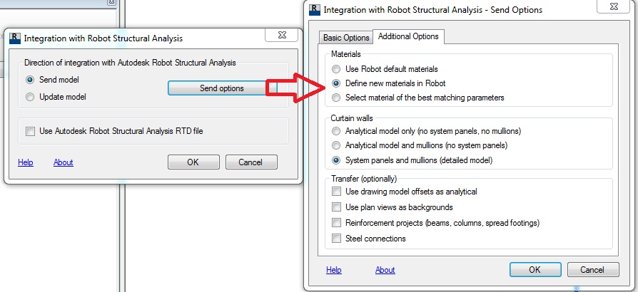

    I have a large model imported from Revit where I have about 10 different materials. While the materials work fine, "Data - Materials" table in the report is filled with N/A. Am I miisng something or is it a bug?

    And additionally what is set on this window while exporting ?

    I used "Define new materials in Robot".
    By materials working fine I mean the results are as expected and when I go to Job preferences -> Materials, all my Revit materials are there with correct properties. It is only the report where I see problems.
    Another issue related to materials: I just noticed that when I create a new project and go to Job preferences -> Materials, the materials imported from Revit are still there. Should not Job preferences be specific to a particular project (job)?

    Thank you for the file. We will investigate why the Properties table has got incorrect display of information on the Materials tab. I have noticed that opening the file in the repair mode causes this tab to show the information correctly.
    No, the assumption is that you want to use the materials you created in Job Preferences not only in one project but in next ones as well. Otherwise you would have to do this each time you e.g. would like to use a 'missing' steel grade.
