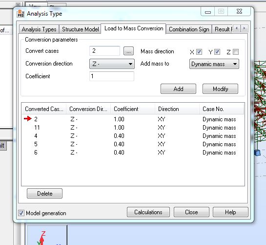

    After I do the modal analysis and am looking to set the NMV in which the most mass participates ,
    i can find the value for Y direction, but not for X
    I am attaching some pics showing the settings I have done
    Thank you in advance,
    Dan,Suciu

    Please, show us Load to Mass conversion parameters.

    i converted the permanent load , dead weight and snow

    Screen capture from your first post shows that a lot of vibration modes with the same frequency of 0.43 Hz was found.
    It suggests local vibrations of some members with very similar properties.
    Does your model contain members with releases and DSC algorithm is active?
    In such case I suggest switching off DSC to avoid/reduce the number of these local vibrations.
    If this post answer your question please click "Accept as Solution". It will help everyone to find answer more quickly!

    even with DSC off , I have the same result and same problem.
    I have releases on bars, and many similair elements(the roof is made out of trusses); releases are applied on the truss nodes so they do not transfer moment to the column

    All those local vibrations are related to lateral vibrations of roof trusses.
    They are not braced in the plane of top or bottom chord so the frequencies of their lateral and torsional vibrations are rather low.
    You can easily check it temporarily deleting load case 11 (selfweight) from load to mass conversion - when mass from selfweight (including selfweight of trusses) is not considered the local vibrations are strongly reduced.
    Generally the model is not braced in planes of roof slopes and it should be done or using dedicated bracings or at least considering the influence of roof plates.
    After adding such bracings local vibrations will be reduced.
    Additional note: I have noticed that load to mass conversion was performed simultaneously for snow load cases 4to6. Are these load cases excluding between each other? If yes then only one of them should be converted to mass.
