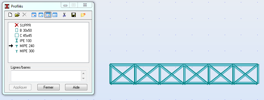

    Hi   I downloaded trial version of ARSAP 2013
    je telecharger la version 2013 et je voulais faire quelque exemple, mais quand je choisie le icon de structure type, RSAP fait un message d'erreur de que je clic deux fois sur la structure que je veux choisir

    The message suggests that you tried to load one of the library structures. Could you check what materials (French or English/Eurocode) as well as section databases you have got set in Job Preferences? Mind that for French language ACIER material has to be available. In case it is missing add create it e.g. using Steel as the reference.

    truss.PNGIn case some of bars (posts and diagonals) do not have assigned sections after you press OK (ignore any displayed warnings) select them and assign sections using the Sections dialog instead.

    i use canada franch version, it is trial version, in picture the are what i have when i try to use tipical structure

    Comme indique' dans le message 5, il faut verifier la compatibilite' de la base des materiaux avec les preferences regionales:
    veuillez verifier que vous avez bien les parametres affiches dans les captures ci-dessous:

    Utiliser les preferences indiquees pour generer la structure, ensuite modifier les sections de votre treillis.
