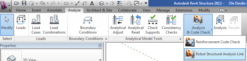

    I am trying to get update my revit model from robot. Everything is working just fine, except transfer of reinforcement.
    What can I do to fix this problem?
    I update from revit as shown below
    I use the following settings
    And I get the following message
    And the following error
    Any help on this matter would be much appreciated:-)
    In addition, I have not figured out a way to update my robot model from revit. Is this even possible, and if so how is it done?
    Regards
    Peder

    Please upload robot file

    The movie how it works on my side here:
    https://www.filemail.com/dl.aspx?id=DFBPROFUIDGSNHH
    NOTE: The issues can be related to reinforcement You generated in Robot.

    The prosess you demonstraded is exactly the same as I have done.
    So I reinstalled revit which did not help. But when I uninstalled it and intalled it again it works perfectly.
    Thanks again:smileyhappy:

    I have a follow up question,
    Do you have solution for transfer of wall and floor reinforcement from Robot to Revit?
    Product Support
    Posts: 770
    Registered: 04-26-2010
    Re: Integration REVIT <-> ROBOT
    02-21-2012 03:21 AM in reply to: pevelor
    Currently it is not possible to transfer plate and walls reinforcement from Robot to Revit.
