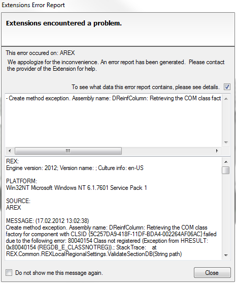

    I am trying to get update my revit model from robot. Everything is working just fine, except transfer of reinforcement.
    What can I do to fix this problem?
    I update from revit as shown below
    I use the following settings
    And I get the following message
    And the following error
    Any help on this matter would be much appreciated:-)
    In addition, I have not figured out a way to update my robot model from revit. Is this even possible, and if so how is it done?

    Re: Integration REVIT <-> ROBOT
    02-17-2012 04:18 AM in reply to: pevelor
    Please upload robot file
    02-20-2012 01:25 AM in reply to: RG_Adsk
    Thanks for the video upload.
    The prosess you demonstraded is exactly the same as I have done.
    So I reinstalled revit which did not help. But when I uninstalled it and intalled it again it works perfectly.
    Thanks again:smileyhappy:
