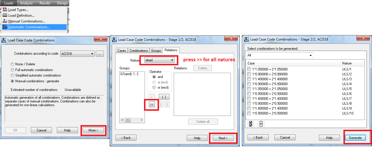

    Thank you . But how do you do this correction?
    Next time if I encounter with this problem what should I do?

    Re: Error on provided reinforcement
    10-08-2012 04:01 AM in reply to: MohammadZaman
