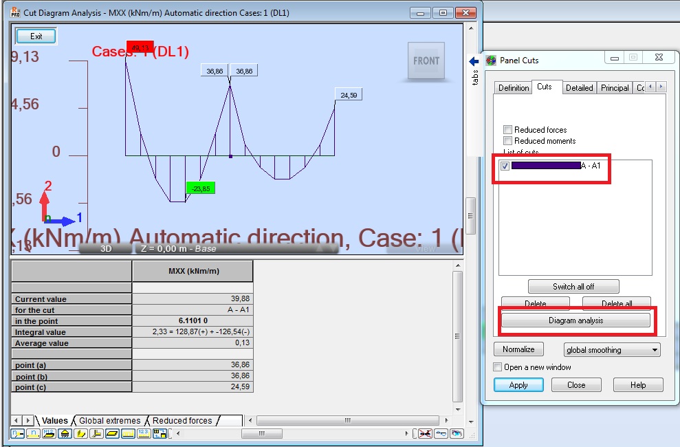

    Artur, Is there a way to move labels from panel cuts?? And also , still on panel cuts , any way of having more values for a single cut ,other than dividing the original cut in several other cuts? Right now ,labels shown are just max/min wish list?? :-)

    Unfortunately it is not possible to move panels cuts labels.
    More values you can see if you make diagram analysis.

    In addition when you click on the 6.11 value field and then move the cursor over the diagram you will be able to check the value s along the cut moving it right and left.

    Artur and RG_Adsk , Yes I know about the diagram analysis capabilities. They´re great!! But I´m talking more about printouts. It would be great if we could have a large slab or wall with several cuts shown in the same screenshot with their local extremes(more than 2 if aplicable) . And for that it would be great( or necessary) to be able to move the labels.
