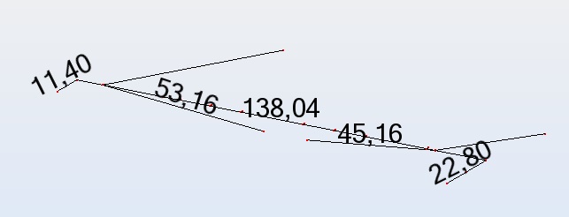

    sorgjee wrote:
    Thanks, the code for the mapping works for me, except the symbol size is refusing to change frmo anyting other than 3. ANy idea what is causing this?
    (Keep in mind that this approach may not display member lengths on all members - take a look at Romanich screen shot)
    Do you refresh after?
    Is there a way of setting the scale colours to black through the API?
    I am afradi not possible.
    Trying to make the print as neat as possible.
    Try this code :
    viewRobot.ParamsBarMap.CurrentResult = I_VBMRT_DESIGN_MEMBER_LENGTH
    viewRobot.ParamsBarMap.Descriptions = I_VDDT_TEXT
    viewRobot.ParamsBarMap.MapThicknessCoeff = 1
    viewRobot.ParamsDisplay.SymbolSize = 5
    viewRobot.ParamsDisplay.Set I_VDA_VIEWOGL_BLACK_EDGES, True
    RobApp.Project.ViewMngr.Refresh

    Hi Rafal,
    Thanks _BLACK_EDGES works a treat.
    No idea about why the SymbolSize is not working . Was running smoothly last night. Will try different computer and see if it makes any difference.
    One more question though, after setting BarMap, how do I revert to a 'normal' view. Using ParamsBarMap.CurrentResult - I_VBMRT_NOTHING simply makes the bars disappear completely.
    This should work:
    viewRobot.ParamsBarMap.Descriptions = I_VDDT_NONE
    viewRobot.ParamsBarMap.CurrentResult = -1
    viewRobot.ParamsDisplay.Set I_VDA_VIEWOGL_BLACK_EDGES, False
