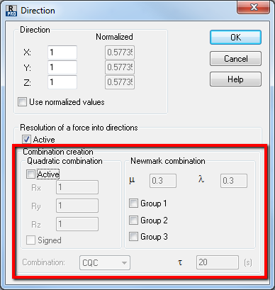

    According to EN 1998-1:2004 4.3.3.1 (11), the seismic excitation must be applied to all relevant directions.
    For some structures there might be more than 2 relevant directions, and these directions may deviate from the directions of the global X- and Y-direction in the Robot model.
    In my understanding of Robot, this should be possible when using the button "direction definition" in the "EN 1998 Parameters" dialog box.
    I have tried this to a simple model, but it does not seem to work properly.
    Have anyone tried something similar, with good results?

    you must use Quadratic or Newmark combinations:

    Keep in mind that unlike Newmark combination rule, SRSS rule is not direction dependant.
    Rotating the building + newmark rule i guess will do the job.

    Hi,....
    ....just to clarify,.... According to EC8 all the structure's members should "resist" 100% of the prescribed seismic forces in one direction plus 30%  of the prescribed forces in the perpendicular direction!
    i.e.:
    1Edx"+"0,3Edy
    0,3Edx"+1Edy
    when Z direction is disregarded.
    So, what I need to check in the "Direction definition" is......
    Am I wrong?

    You seem to have set it up correctly.
