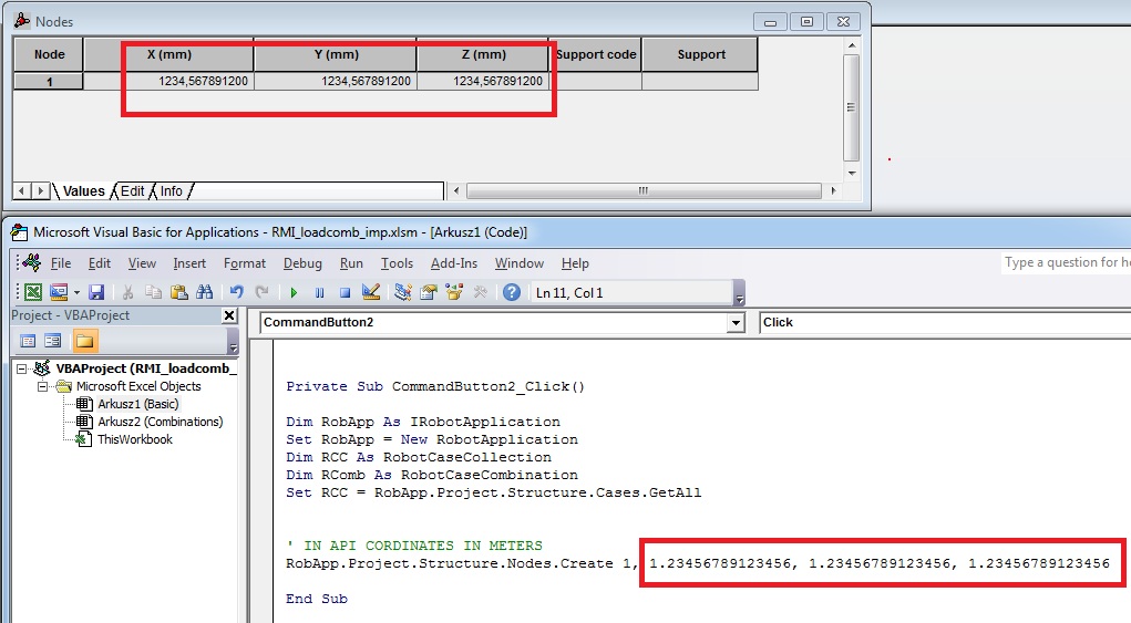

    I have a macro to export a model from cad to Robot using API.
    I would like to know what is the criteria that Robot uses to round the dimensions of elements that came from cad.
    I have this doubt because I've noticed that all the dimensions in cad have more decimal places than the dimensions in Robot.
    Any help will be appreciated.

    Maybe I was not clear: I'm using Robot API.
    For example:
    If I have a line in cad, my macro reads the coordinates of the end points and creates two nodes in Robot with the same coordinates. Then a bar is created using these two nodes as startnode and endnode.
    My problem is that the coordinates that are read in cad have more decimal places than the coordinates that are written in Robot.
    I need to know how Robot rounds the coordinates that receives using API.

    Take a look below:

    I obtain a different result.
    Do you know why?

    Meanwhile, I've made some tests.
    I have exported from excel to robot different nodes with different coordinates and I'm getting different results.
    It's still a mistery (for me) what's the criteria that Robot uses to round the coordinates.
    It seems robot reads up to 9 digits after comma (in meters) in API.
    I had 10 digits yesterday but I do not know how it happend. Today always 9.
